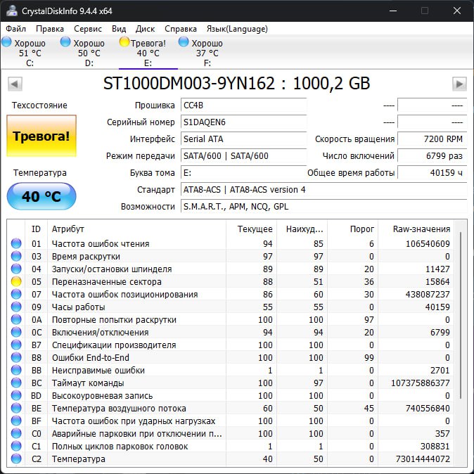

Глянув смарт на попередній сторінці:
Radio Bay: 13.10.2025 05:22 Упс, TOSHIBA DT01ACA300 : 3000,5 GB
Physical Disk Information - Disk: #3: TOSHIBA DT01ACA300 S.M.A.R.T.
Код: Выделить всё
No.  Attribute                Thre.. Value  Worst  Data                Status                   Flags
1    Raw Read Error Rate      16     86     86     0000006C0000        OK                       Error-Rate, Statistical, Critical
2    Throughput Performance   54     139    139    000000000048        OK                       Performance, Critical
3    Spin Up Time             24     132    132    000801B201B3        OK                       Performance, Statistical, Critical
4    Start/Stop Count         0      98     98     0000000026D4        OK (Always passing)      Event Count, Statistical
5    Reallocated Sectors Co.. 5      62     62     000000000352        OK                       Self Preserving, Event Count, Statistical, Critical
7    Seek Error Rate          67     100    100    000000000000        OK                       Error-Rate, Statistical, Critical
8    Seek Time Performance    20     124    124    000000000021        OK                       Performance, Critical
9    Power On Time Count      0      91     91     0000000104F9        OK (Always passing)      Event Count, Statistical
10   Spin Retry Count         60     100    100    000000000000        OK                       Event Count, Statistical, Critical
12   Drive Power Cycle Count  0      98     98     0000000021B7        OK (Always passing)      Self Preserving, Event Count, Statistical
192  Power off Retract Cycl.. 0      92     92     0000000027F2        OK (Always passing)      Self Preserving, Event Count, Statistical
193  Load/Unload Cycle Count  0      92     92     0000000027F2        OK (Always passing)      Event Count, Statistical
194  Disk Temperature         0      171    171    003000090023        OK (Always passing)      Statistical
196  Reallocation Event Count 0      56     56     0000000003CC        OK (Always passing)      Self Preserving, Event Count, Statistical
197  Current Pending Sector.. 0      100    100    000000000058        OK (Always passing)      Self Preserving, Statistical
198  Off-Line Uncorrectable.. 0      100    100    000000000000        OK (Always passing)      Error-Rate
199  Ultra ATA CRC Error Co.. 0      200    200    000000000000        OK (Always passing)      Error-Rate, Statistical
199 Ultra ATA CRC Error Count (Помилки CRC): Це помили кабелю/інтерфейсу, значення 0 - із зв'язком повний порядок.
7 Seek Error Rate: 0 пошукових помилок - теж показник що із зв'язком повний порядок.
Тобто з контактами повний порядок і питання в середині гермоблоку.
Параметри "5 Reallocated Sectors Count" та "197 Current Pending Sector Count" саме про це кажуть в сукупності з параметрами "199" та "7", коли зв'язок по електроніці чудовий, без помилок, але купа біди по секторах. Коротше, сипатися почав диск :-/

Z440_User: 15.10.2025 15:34Коротше, сипатися почав диск
Дяка за інфу, я у цьому не дуже розумію. Отбєкапився, чекаю. Подивимось, що вийде. Мабуть не тільки мені буде цікаво

Radio Bay
Покажешь смарт после? Дико интересно

Avenger80
Аватара пользователя
Откуда: Харьков
Сообщение
Shpoker: 19.10.2025 19:16Это ходячий труп
Так он уже и так в труп превратился - не выдержал сканирование Викторией - отлетел во время сканирования и лечения, неопознанное устройство. :)
