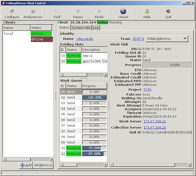

Alexsandr
Zhekawork:3. Ждем конекта.
Хорошая штука такое подключение.
Кто знает что это такое творится, не отправляются задания или???

Alexsandr
да это не отправляются задания, можешь даже в логе посмотреть. Лог в студию пожалуйста :) .
Alexsandr
вот кусок лога. Как лечить?
07:48:10:Connecting to 10.18.100.155:8080
07:48:10:ERROR: Exception: Server responded: HTTP_GATEWAY_TIME_OUT
07:48:10:Sending unit results: id:10 state:SEND project:5783 run:2 clone:13 gen:466 core:0x11 unit:0x000003c76652eda54b391c1d00000586
07:48:10:Unit 10: Uploading 2.30KiB
07:48:10:WARNING: Exception: Failed to send results to work server: Server responded: HTTP_BAD_REQUEST
07:48:10:Trying to send results to collection server
07:48:10:Unit 06: Uploading 2.30KiB
07:48:10:Sending unit results: id:08 state:SEND project:10504 run:31 clone:1 gen:536 core:0x11 unit:0x000004d36652eda54b75ae7800001860
07:48:10:Unit 08: Uploading 2.31KiB
07:48:11:WARNING: Exception: Failed to send results to work server: Server responded: HTTP_BAD_REQUEST
07:48:11:Trying to send results to collection server
07:48:11:Unit 07: Uploading 2.31KiB
07:48:11:Connecting to 10.18.100.155:8080
07:48:11:Sending unit results: id:09 state:SEND project:5781 run:13 clone:329 gen:473 core:0x11 unit:0x000003e36652eda54a5284b000003413
07:48:11:Unit 09: Uploading 2.32KiB
07:48:11:Unit 10: Uploading 2.30KiB
07:48:11:Unit 08: Uploading 2.31KiB
07:48:12:WARNING: Exception: Failed to send results to work server: Server responded: HTTP_BAD_REQUEST
07:48:12:Trying to send results to collection server
07:48:12:Unit 09: Uploading 2.32KiB
07:48:12:Connecting to 10.18.100.155:8080
07:48:31:ERROR: Exception: Server responded: HTTP_GATEWAY_TIME_OUT
07:48:32:ERROR: Exception: Server responded: HTTP_GATEWAY_TIME_OUT
07:48:33:ERROR: Exception: Server responded: HTTP_GATEWAY_TIME_OUT
