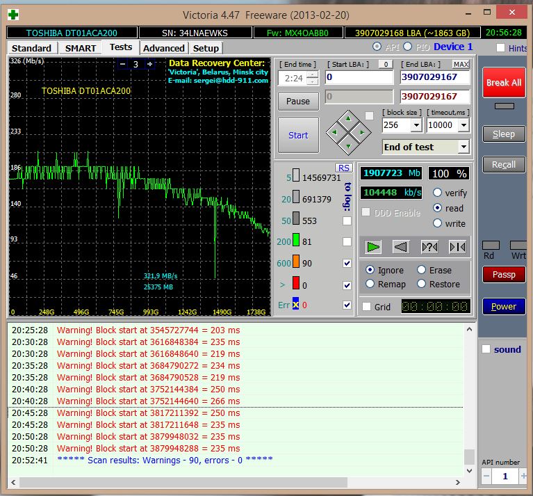

Просканував перший диск, лог зберіг.
17:22:49 : Model: TOSHIBA DT01ACA200; Capacity: 3907029168 LBAs; SN: 34LNAEWKS; FW: MX4OABB0
17:23:22 : Get passport... OK
17:23:22 : Recallibration... OK
17:23:22 : Starting Reading, LBA=0..3907029167, sequential access, timeout 10000ms
17:25:27 : Warning! Block start at 43051520 = 234 ms
20:52:41 : ***** Scan results: Warnings - 90, errors - 0 *****
