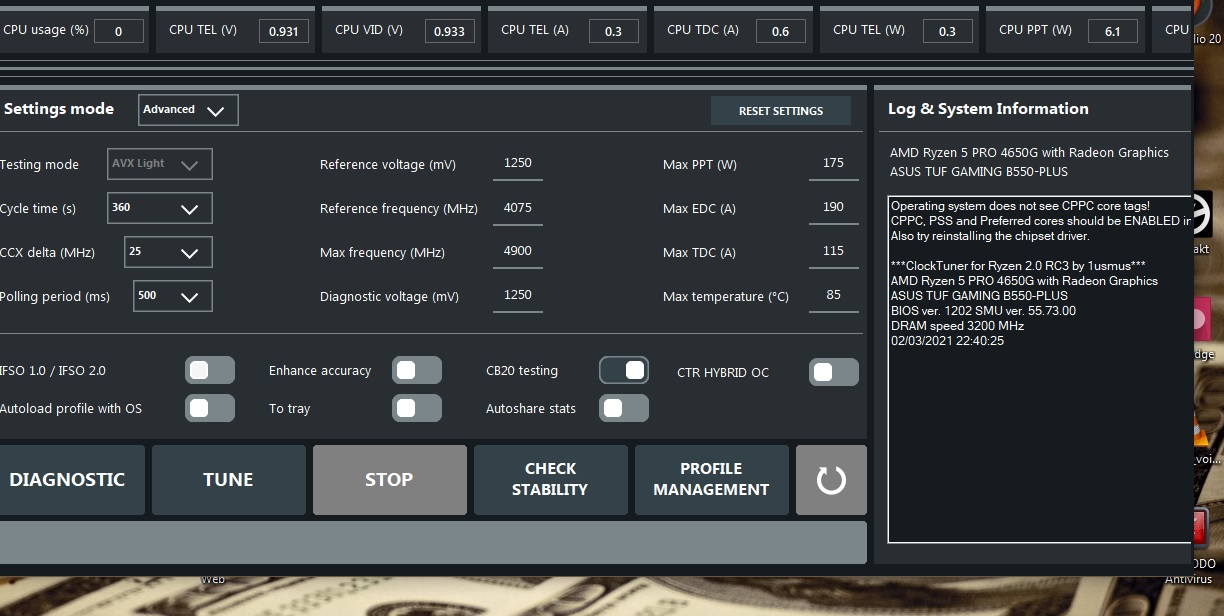

LightningUA
CTR не хочет масштабироваться на мой монитор. Точнее, он не хочет выводить правую сторону, даже если я двигаю окно
1440х900
- спойлер
1440х900

0:25:42: Stress test #1 started...
0:25:48: CPU Vdroop: 3 % temperature: 65,7°
0:27:50: Stress test stopped.
0:27:52: Stress test #2 started...
0:27:58: CPU Vdroop: 3 % temperature: 65,7°
0:30:00: Stress test stopped.
0:30:02: Stress test #3 started...
0:30:08: CPU Vdroop: 3 % temperature: 66,4°
0:32:11: Stress test stopped.
0:32:12: Stress test #4 started...
0:32:18: CPU Vdroop: 2,9 % temperature: 66,1°
0:34:21: Stress test stopped.
Step# 9
0:34:22: WHEA-counter: 1
0:34:22: CCX1 (158): 4700 MHz, 1332 mV OC=
0:34:22: CCX2 (133): 4675 MHz, 1332 mV OC+
0:34:23: Stress test #1 started...
0:34:28: CPU Vdroop: 3,2 % temperature: 65,4°
0:36:31: Stress test stopped.
0:36:32: Stress test #2 started...
0:36:38: CPU Vdroop: 3,1 % temperature: 65,3°
0:38:41: Stress test stopped.
0:38:42: Stress test #3 started...
0:38:48: CPU Vdroop: 3,1 % temperature: 65,9°
0:40:51: Stress test stopped.
0:40:52: Stress test #4 started...
0:40:58: CPU Vdroop: 3,1 % temperature: 66,3°
0:43:01: Stress test stopped.
Step# 10
0:43:01: WHEA-counter: 1
0:43:01: CCX1 (158): 4700 MHz, 1350 mV OC=
0:43:01: CCX2 (133): 4700 MHz, 1350 mV OC+
0:43:02: Stress test #1 started...
0:43:08: CPU Vdroop: 3,2 % temperature: 66,2°
0:45:11: Stress test stopped.
0:45:12: Stress test #2 started...
0:45:18: CPU Vdroop: 3,1 % temperature: 67,1°
0:47:21: Stress test stopped.
0:47:22: Stress test #3 started...
0:47:28: CPU Vdroop: 3,2 % temperature: 67,9°
0:49:31: Stress test stopped.
0:49:33: Stress test #4 started...
0:49:38: CPU Vdroop: 3,1 % temperature: 66,9°
0:51:41: Stress test stopped.
Step# 11
0:51:42: WHEA-counter: 1
0:51:42: CCX1 (158): 4700 MHz, 1344 mV OC=
0:51:42: CCX2 (133): 4700 MHz, 1344 mV OC+
0:51:43: Stress test #1 started...
0:51:49: CPU Vdroop: 3,1 % temperature: 65,8°
0:53:52: Stress test stopped.
0:53:53: Stress test #2 started...
0:53:59: CPU Vdroop: 3,1 % temperature: 66°
0:56:02: Stress test stopped.
0:56:04: Stress test #3 started...
0:56:09: CPU Vdroop: 3,1 % temperature: 66,6°
0:58:12: Stress test stopped.
0:58:14: Stress test #4 started...
0:58:20: CPU Vdroop: 3,1 % temperature: 66,5°
1:00:23: Stress test stopped.
Step# 12
1:00:23: WHEA-counter: 1
1:00:23: CCX1 (158): 4700 MHz, 1338 mV OC=
1:00:23: CCX2 (133): 4700 MHz, 1338 mV OC+
1:00:24: Stress test #1 started...
1:00:30: CPU Vdroop: 3 % temperature: 67,1°
1:02:33: Stress test stopped.
1:02:34: Stress test #2 started...
1:02:40: CPU Vdroop: 3 % temperature: 65,7°
1:04:43: Stress test stopped.
1:04:45: Stress test #3 started...
1:04:50: CPU Vdroop: 3 % temperature: 66,1°
1:06:53: Stress test stopped.
1:06:55: Stress test #4 started...
1:07:00: CPU Vdroop: 3,1 % temperature: 66,6°
1:09:03: Stress test stopped.
Step# 13
1:09:04: WHEA-counter: 1
1:09:04: CCX1 (158): 4700 MHz, 1332 mV OC=
1:09:04: CCX2 (133): 4700 MHz, 1332 mV OC+
1:09:05: Stress test #1 started...
1:09:11: CPU Vdroop: 3,1 % temperature: 65,3°
1:11:13: Stress test stopped.
1:11:15: Stress test #2 started...
1:11:21: CPU Vdroop: 3,1 % temperature: 65,1°
1:13:23: Stress test stopped.
1:13:25: Stress test #3 started...
1:13:31: CPU Vdroop: 3,1 % temperature: 65,6°
1:15:34: Stress test stopped.
1:15:35: Stress test #4 started...
1:15:41: CPU Vdroop: 3,1 % temperature: 65,5°
1:17:44: Stress test stopped.
Step# 14
1:17:45: WHEA-counter: 1
1:17:45: CCX1 (158): 4700 MHz, 1350 mV OC=
1:17:45: CCX2 (133): 4725 MHz, 1350 mV OC+
1:17:46: Stress test #1 started...
1:17:51: CPU Vdroop: 3,1 % temperature: 67,1°
1:19:54: Stress test stopped.
1:19:55: Stress test #2 started...
1:20:01: CPU Vdroop: 3,2 % temperature: 66,7°
1:22:04: Stress test stopped.
1:22:05: Stress test #3 started...
1:22:11: CPU Vdroop: 3,1 % temperature: 66,4°
1:24:14: Stress test stopped.
1:24:15: Stress test #4 started...
1:24:21: CPU Vdroop: 3,1 % temperature: 67°
1:26:24: Stress test stopped.
Step# 15
1:26:24: WHEA-counter: 1
1:26:24: CCX1 (158): 4700 MHz, 1344 mV OC=
1:26:24: CCX2 (133): 4725 MHz, 1344 mV OC+
1:26:25: Stress test #1 started...
1:26:31: CPU Vdroop: 3,1 % temperature: 65,9°
1:28:34: Stress test stopped.
1:28:35: Stress test #2 started...
1:28:41: CPU Vdroop: 3,1 % temperature: 66,3°
1:30:44: Stress test stopped.
1:30:45: Stress test #3 started...
1:30:51: CPU Vdroop: 3,1 % temperature: 66,5°
1:32:54: Stress test stopped.
1:32:55: Stress test #4 started...
1:33:01: CPU Vdroop: 3,1 % temperature: 66,4°
1:35:04: Stress test stopped.
Step# 16
1:35:04: WHEA-counter: 1
1:35:04: CCX1 (158): 4700 MHz, 1338 mV OC=
1:35:04: CCX2 (133): 4725 MHz, 1338 mV OC+
1:35:05: Stress test #1 started...
1:35:11: CPU Vdroop: 3 % temperature: 65,6°
1:37:14: Stress test stopped.
1:37:15: Stress test #2 started...
1:37:21: CPU Vdroop: 3 % temperature: 65,7°
1:39:24: Stress test stopped.
1:39:25: Stress test #3 started...
1:39:31: CPU Vdroop: 3 % temperature: 66,5°
1:41:34: Stress test stopped.
1:41:35: Stress test #4 started...
1:41:41: CPU Vdroop: 3,3 % temperature: 78,7°
1:43:44: Stress test stopped.
Step# 17
1:43:44: WHEA-counter: 1
1:43:44: CCX1 (158): 4700 MHz, 1332 mV OC=
1:43:44: CCX2 (133): 4725 MHz, 1332 mV OC+
1:43:45: Stress test #1 started...
1:43:51: CPU Vdroop: 3,1 % temperature: 65,7°
1:45:54: Stress test stopped.
1:45:55: Stress test #2 started...
1:46:01: CPU Vdroop: 3,1 % temperature: 65,6°
1:48:03: Stress test stopped.
1:48:05: Stress test #3 started...
1:48:11: CPU Vdroop: 3,1 % temperature: 65,4°
1:50:13: Stress test stopped.
1:50:15: Stress test #4 started...
1:50:21: CPU Vdroop: 3,1 % temperature: 65,6°
1:52:23: Stress test stopped.
Step# 18
1:52:24: WHEA-counter: 1
1:52:24: CCX1 (158): 4700 MHz, 1350 mV OC=
1:52:24: CCX2 (133): 4750 MHz, 1350 mV OC+
1:52:25: Stress test #1 started...
1:52:31: CPU Vdroop: 3,2 % temperature: 66,5°
1:54:34: Stress test stopped.
1:54:35: Stress test #2 started...
1:54:41: CPU Vdroop: 3,1 % temperature: 67,3°
1:56:43: Stress test stopped.
1:56:45: Stress test #3 started...
1:56:50: CPU Vdroop: 3,2 % temperature: 66,9°
1:58:53: Stress test stopped.
1:58:54: Stress test #4 started...
1:59:00: CPU Vdroop: 3,1 % temperature: 66,5°
2:01:03: Stress test stopped.
Step# 19
2:01:03: WHEA-counter: 1
2:01:03: CCX1 (158): 4700 MHz, 1344 mV OC=
2:01:03: CCX2 (133): 4750 MHz, 1344 mV OC+
2:01:04: Stress test #1 started...
2:01:10: CPU Vdroop: 3,1 % temperature: 66,3°
2:03:13: Stress test stopped.
2:03:14: Stress test #2 started...
2:03:20: CPU Vdroop: 3,1 % temperature: 65,8°
2:05:22: Stress test stopped.
2:05:24: Stress test #3 started...
2:05:30: CPU Vdroop: 3,1 % temperature: 67,3°
2:07:32: Stress test stopped.
2:07:33: Stress test #4 started...
2:07:39: CPU Vdroop: 3,1 % temperature: 66,3°
2:09:42: Stress test stopped.
Step# 20
2:09:43: WHEA-counter: 1
2:09:43: CCX1 (158): 4700 MHz, 1338 mV OC=
2:09:43: CCX2 (133): 4750 MHz, 1338 mV OC+
2:09:44: Stress test #1 started...
2:09:49: CPU Vdroop: 3 % temperature: 66,2°
2:11:52: Stress test stopped.
2:11:53: Stress test #2 started...
2:11:59: CPU Vdroop: 3 % temperature: 66,1°
2:14:02: Stress test stopped.
2:14:04: Stress test #3 started...
2:14:09: CPU Vdroop: 3 % temperature: 65,8°
2:16:12: Stress test stopped.
2:16:14: Stress test #4 started...
2:16:20: CPU Vdroop: 3 % temperature: 65,8°
2:18:22: Stress test stopped.
Step# 21
2:18:23: WHEA-counter: 1
2:18:23: CCX1 (158): 4700 MHz, 1332 mV OC=
2:18:23: CCX2 (133): 4750 MHz, 1332 mV OC+
2:18:24: Stress test #1 started...
2:18:30: CPU Vdroop: 3,1 % temperature: 65,6°
2:20:32: Stress test stopped.
2:20:34: Stress test #2 started...
2:20:39: CPU Vdroop: 3,1 % temperature: 64,8°
2:22:42: Stress test stopped.
2:22:44: Stress test #3 started...
2:22:49: CPU Vdroop: 3 % temperature: 65,4°
2:24:52: Stress test stopped.
2:24:54: Stress test #4 started...
2:25:00: CPU Vdroop: 3,2 % temperature: 65,6°
2:27:02: Stress test stopped.
Step# 22
2:27:03: WHEA-counter: 1
2:27:03: CCX1 (158): 4700 MHz, 1350 mV OC=
2:27:03: CCX2 (133): 4775 MHz, 1350 mV OC+
2:27:04: Stress test #1 started...
2:27:10: CPU Vdroop: 3,2 % temperature: 66,8°
2:29:12: Stress test stopped.
2:29:14: Stress test #2 started...
2:29:20: CPU Vdroop: 3,2 % temperature: 67,1°
2:31:22: Stress test stopped.
2:31:24: Stress test #3 started...
2:31:30: CPU Vdroop: 3,2 % temperature: 67,2°
2:33:32: Stress test stopped.
2:33:34: Stress test #4 started...
2:33:40: CPU Vdroop: 3,1 % temperature: 67,4°
2:35:43: Stress test stopped.
Step# 23
2:35:43: WHEA-counter: 1
2:35:43: CCX1 (158): 4700 MHz, 1344 mV OC=
2:35:43: CCX2 (133): 4775 MHz, 1344 mV OC+
2:35:44: Stress test #1 started...
2:35:50: CPU Vdroop: 3,1 % temperature: 65,9°
2:37:53: Stress test stopped.
2:37:54: Stress test #2 started...
2:38:00: CPU Vdroop: 3,1 % temperature: 66,6°
2:40:03: Stress test stopped.
2:40:04: Stress test #3 started...
2:40:10: CPU Vdroop: 3,1 % temperature: 66,3°
2:42:13: Stress test stopped.
2:42:14: Stress test #4 started...
2:42:20: CPU Vdroop: 3,1 % temperature: 67°
2:44:23: Stress test stopped.
Step# 24
2:44:24: WHEA-counter: 1
2:44:24: CCX1 (158): 4700 MHz, 1338 mV OC=
2:44:24: CCX2 (133): 4775 MHz, 1338 mV OC+
2:44:25: Stress test #1 started...
2:44:30: CPU Vdroop: 3 % temperature: 65,5°
2:46:33: Stress test stopped.
2:46:34: Stress test #2 started...
2:46:40: CPU Vdroop: 3 % temperature: 65,5°
2:48:43: Stress test stopped.
2:48:44: Stress test #3 started...
2:48:50: CPU Vdroop: 3 % temperature: 66,7°
2:50:53: Stress test stopped.
2:50:54: Stress test #4 started...
2:51:00: CPU Vdroop: 2,8 % temperature: 65,6°
2:53:03: Stress test stopped.
Step# 25
2:53:04: WHEA-counter: 1
2:53:04: CCX1 (158): 4700 MHz, 1332 mV OC=
2:53:04: CCX2 (133): 4775 MHz, 1332 mV OC+
2:53:05: Stress test #1 started...
2:53:10: CPU Vdroop: 3,1 % temperature: 65,6°
2:55:12: Stress test stopped.
2:55:14: Stress test #2 started...
2:55:19: CPU Vdroop: 3 % temperature: 65,9°
2:57:22: Stress test stopped.
2:57:24: Stress test #3 started...
2:57:30: CPU Vdroop: 3,1 % temperature: 65,8°
2:59:32: Stress test stopped.
2:59:34: Stress test #4 started...
2:59:39: CPU Vdroop: 3,1 % temperature: 64,7°
3:01:42: Stress test stopped.
Step# 26
3:01:43: WHEA-counter: 1
3:01:43: CCX1 (158): 4700 MHz, 1350 mV OC=
3:01:43: CCX2 (133): 4800 MHz, 1350 mV OC+
3:01:44: Stress test #1 started...
3:01:49: CPU Vdroop: 3,1 % temperature: 66,9°
3:03:52: Stress test stopped.
3:03:54: Stress test #2 started...
3:04:00: CPU Vdroop: 3,1 % temperature: 66,6°
3:06:02: Stress test stopped.
3:06:04: Stress test #3 started...
3:06:10: CPU Vdroop: 3,2 % temperature: 67,5°
3:08:13: Stress test stopped.
3:08:14: Stress test #4 started...
3:08:20: CPU Vdroop: 3,1 % temperature: 66,9°
3:10:23: Stress test stopped.
Step# 27
3:10:23: WHEA-counter: 1
3:10:23: CCX1 (158): 4700 MHz, 1344 mV OC=
3:10:23: CCX2 (133): 4800 MHz, 1344 mV OC+
3:10:24: Stress test #1 started...
3:10:30: CPU Vdroop: 3,1 % temperature: 66,7°
3:12:33: Stress test stopped.
3:12:34: Stress test #2 started...
3:12:40: CPU Vdroop: 3,1 % temperature: 66,6°
3:14:43: Stress test stopped.
3:14:44: Stress test #3 started...
3:14:50: CPU Vdroop: 3,1 % temperature: 67,2°
3:16:53: Stress test stopped.
3:16:54: Stress test #4 started...
3:17:00: CPU Vdroop: 3,1 % temperature: 66,8°
3:19:03: Stress test stopped.
Step# 28
3:19:03: WHEA-counter: 1
3:19:03: CCX1 (158): 4700 MHz, 1338 mV OC=
3:19:03: CCX2 (133): 4800 MHz, 1338 mV OC+
3:19:04: Stress test #1 started...
3:19:10: CPU Vdroop: 3 % temperature: 65,7°
3:21:13: Stress test stopped.
3:21:14: Stress test #2 started...
3:21:20: CPU Vdroop: 3 % temperature: 66,1°
3:23:23: Stress test stopped.
3:23:24: Stress test #3 started...
3:23:30: CPU Vdroop: 3 % temperature: 66,5°
3:25:33: Stress test stopped.
3:25:34: Stress test #4 started...
3:25:40: CPU Vdroop: 3 % temperature: 65,7°
3:27:43: Stress test stopped.
Step# 29
3:27:44: WHEA-counter: 1
3:27:44: CCX1 (158): 4700 MHz, 1332 mV OC=
3:27:44: CCX2 (133): 4800 MHz, 1332 mV OC+
3:27:45: Stress test #1 started...
3:27:51: CPU Vdroop: 3,1 % temperature: 64,8°
3:29:53: Stress test stopped.
3:29:55: Stress test #2 started...
3:30:00: CPU Vdroop: 3,1 % temperature: 65,5°
3:32:03: Stress test stopped.
3:32:05: Stress test #3 started...
3:32:10: CPU Vdroop: 3,2 % temperature: 65°
3:34:13: Stress test stopped.
3:34:15: Stress test #4 started...
3:34:21: CPU Vdroop: 3,1 % temperature: 65,3°
Phoenix - hello there
CTR completed profile creation in alternative mode
Last step was:
CCX1 4700 MHz VID 1350 mV
CCX2 4800 MHz VID 1350 mV
Manual overclocking mode enabled
Penalties for the final profile: level 1
03:36:51: CCX1 (158): 4650 MHz, 1363 mV OC=
03:36:51: CCX2 (133): 4725 MHz, 1363 mV OC+
Phoenix deactivated!
- Диагностика с стандартными настройками выдала такой результат
